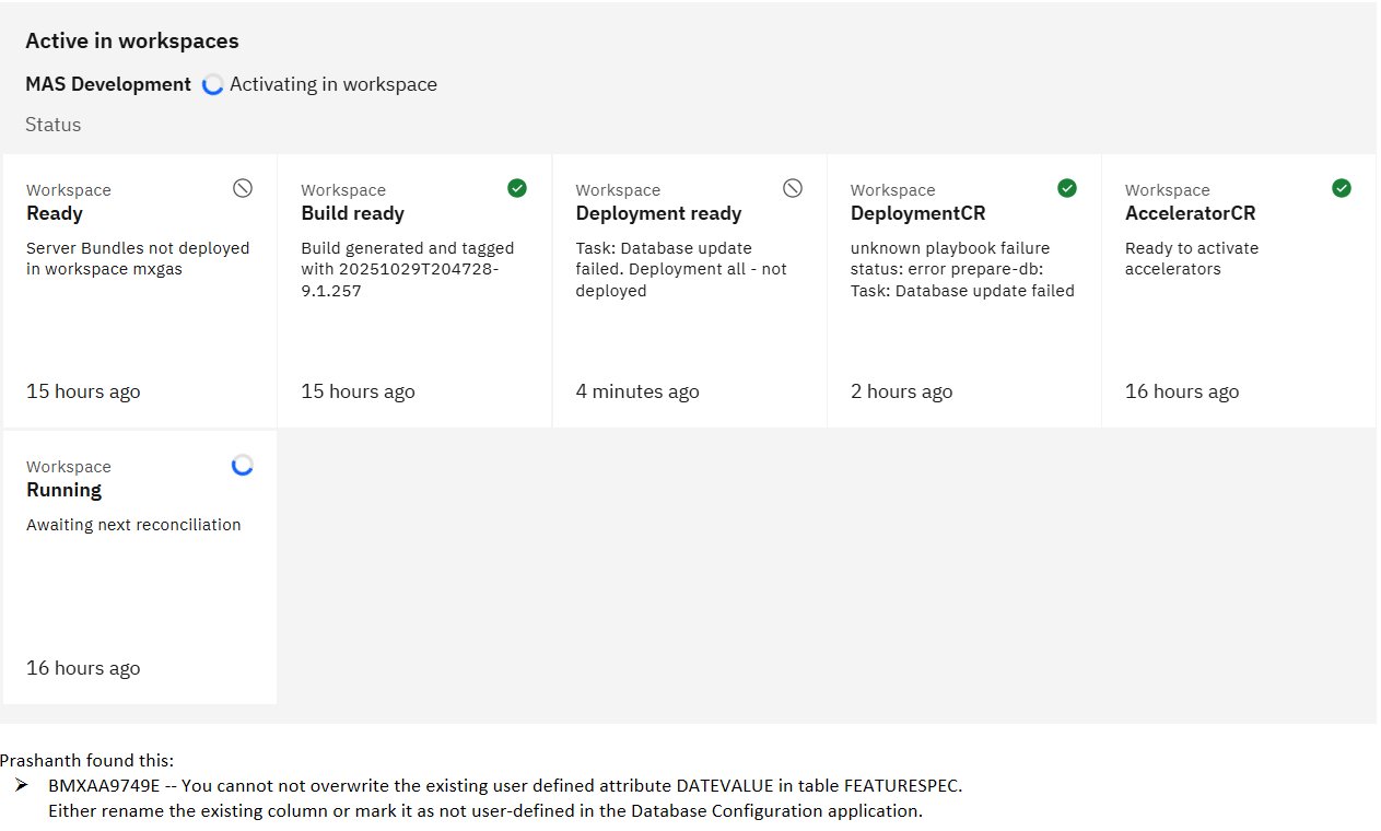

Improved visibility to error messages during upgrade from eam 7.6.1.3 to mas/manage 9.1.4
We got stuck on the deployment screen for a while, because we weren't aware there was a backend database-validation check that the upgrade process had detected that was blocking the upgrade.  The open shift team had to help find that error message in their logs, but our team (mas/manage team) couldn't see that error detail; would've saved us time instead of waiting for the upgrade to advance when it was actually stuck.

    Hi
    We are reviewing this requirement. To understand this further we would like to know if the "updatddb" failed during this process or it was still running?
